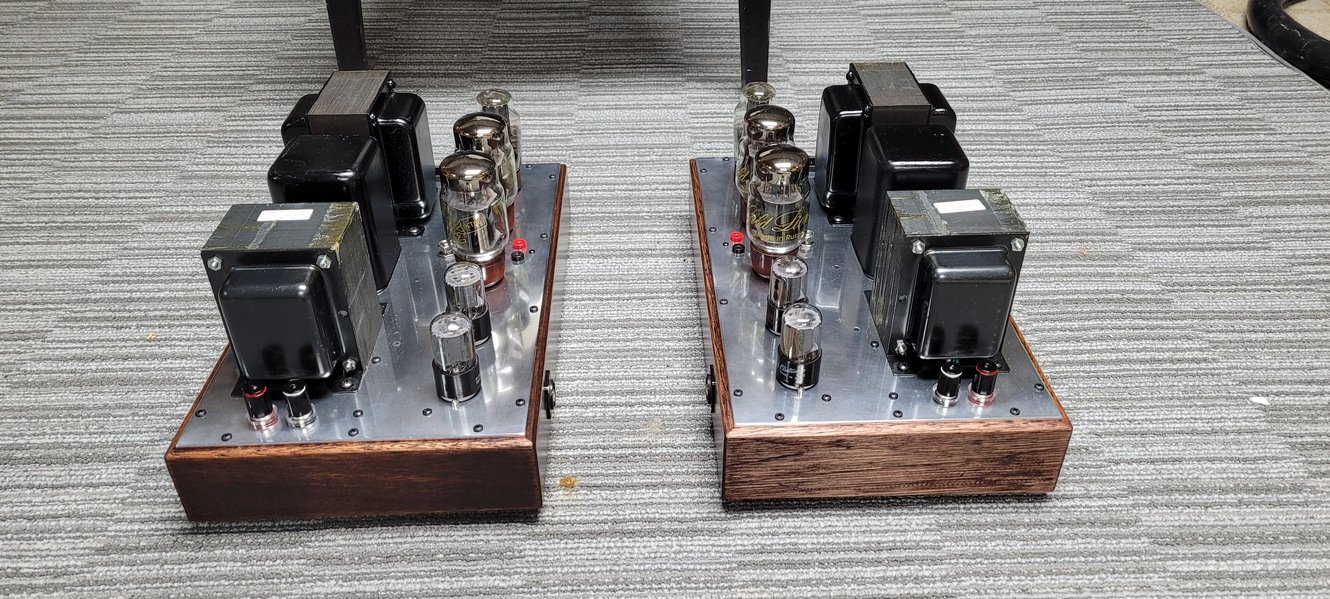

PostPosted: October 12th, 2022, 7:00 am
All,
Apologies for reviving an old thread, but I just wanted to post a followup on this project. Grover shared his experience, advice, and recommendations with me over the past couple of years and I finally completed a pair of "Gilded Lily" versions of the Sarser and Sprinkle "Musicians Amplifier" using the Heyboer reproduction Peerless S-265-Q output transformers like the original. Part of the reason it took me so long was it was a year wait on the transformers. They are still breaking in, but are wonderful sounding amplifiers. PP KT66 Williamson design.
BTW, the basis is an article in Nov 1949 Audio Engineering magazine (updated to UL operation in a followup article in 1952). Grover shared his current schematic reflecting some updates to improve stability and feedback network values for the transformers. Used modern parts including PP DC-Link capacitors and ultra high reliability KEMET 600V electrolytic capacitors in the power supply (increasing storage value over the original). Also used CDE 942C/1000V PP coupling caps. Amazing that a 70 year old amplifier design can sound so damn good.

PostPosted: October 12th, 2022, 9:03 am
David:
Another example of your exceptional craftsmanship. Kudos on the result.
 Post subject: Re: Musician's Amplifier
PostPosted: October 12th, 2022, 10:39 am
Got to love mirror image monoblocks!
