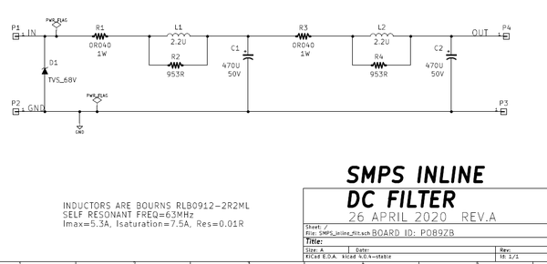

I found this on the DIYAudio Forum
https://www.diyaudio.com/forums/analog-line-level/354213-po89zb-inline-dc-filter-smps-wall-warts-preamps-hpa-korg-nutube-etc.html
from the dialogue, this seems to be blessed by Nelson Pass and is a very simple circuit

Tom, in your schematic, what's the purpose of R2?

This will work as a filter and will probably be better than nothing but there are a few things I would do differently:
D1 appears to be a varistor used as a clamp. However, it is rated at 68V with a maximum clamping voltage of 145V. If that voltage were reached, everything downline would probably be toast. In reality, I don't see the need for a varistor on the output of most wall wart power supplies.
The chokes used are only 2 uh which in conjunction with the capacitors used will have a turnover frequency much higher than the combination of the 2.5 mh choke I'm using in conjunction with much higher capacitance. This circuit will filter out the highest frequency noise but will not be effective at lower frequencies. How that will affect the sound I don't have a clue. It will depend on the circuit being fed.
All the capacitors used are electrolytics which are not very good at filtering out high frequencies. Remember that the monolithic ceramics I use on the output are doing double duty, not only filtering anything that might get to the output from the power supply side but also reducing any high frequency noise generated by the buck regulators internal to the NUC. You can see how the output of the linear power supply had the noise reduced by the addition of the filter. The linear supply probably could not reduce the noise being generated by the buck regulators.
The high amount of capacitance in my version also serves as a huge current sink so that any current pulsed caused by the bucking regulators will not affect the voltage on the input to the NUC nearly as much as the smaller storage in this circuit. Will it matter? Who knows?
One thing for sure, the circuit I am using is certainly bullet proof and may be overkill, but it is simple and cheap. In reality, this circuit seems to be no simpler or more complicated than the one I am using. Both should be a slam dunk for any DIYer to build.
PostPosted: June 2nd, 2021, 3:04 pm
David Berning suggested that adding that would help damp any possible resonances between the filter output section and who knows what from the NUC. He certainly has had a lot of experience with switchers so I took his advice.
PostPosted: June 2nd, 2021, 3:20 pm
I don't see how it's going to do much considering all the rest of the caps after the mosfet have no resistor in series... Now, if all the caps from C11-C23 connected through R2, then I can see it actually having an effect.
PostPosted: June 2nd, 2021, 5:00 pm
David has had some crazy things happen in switch mode power supplies. In one amp he had a resonance develop between the power supply output and a bypass cap in the amplifier section input that blew a fuse that was higher rated than the current coming out of the power supply. He found that there was a resonant circuit that was passing enough current back and forth across the fuse that was higher than the DC draw and higher than the fuse rating. That is where damping can come in. I believe that the combination of the resistor and capacitor can help damp any resonance in the connection between the output and the NUC. The large electrolytic has enough internal impedance that it will probably not contribute to the problem and the monolithic ceramics are often specified especially in high gain Op Amp circuits because they also do not tend to resonate. The one capacitor and series resistor can act as a sink for resonant currents. That section may nor have any effect, but it couldn't hurt so I put it in.
PostPosted: June 2nd, 2021, 5:36 pm
Anytime you have series L/C or parallel L/C circuits you will have the possibility of resonance -- and not in a good way. I have had great success damping speaker crossovers, pulse transformers in digital playback equipment, and last but certainly not least, damping amplifier inter-stage and output audio transformers. "Smearing the signal", the least objectionable problem, can be cleaned up with damping -- and the worst issue is when the resonance can be easily mistaken for mechanical issues or some sort of distortion that typically is blamed on other possibilities such as passive parts or active devices or both.
Every damn thing taking up residence in the signal path from the microphones through to the loud speakers, in this quest for the "Absolute Sound," can impact the end result.
