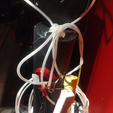

prototyping an xover for super tweeter
out side and hot glue for easy changing componebts

PostPosted: January 11th, 2019, 10:29 am
There are many good reasons for external xovers.
Being able to change component values.
Components not being affected by the vibrations of the drivers.
But being outside gets rid of size constraints, complete freedom of proper inductor orientation.
Easily being able to go to electronic xover and bi-amping
