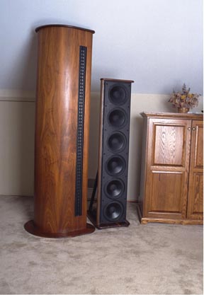

If you remember my line array, it is in a dipole configuration so I didn't worry about box size. If you use a closed box you might want to break it into sections depending on the length to prevent any "organ pipe" resonances.

If I were to do an open baffle arrangement, How wide should the baffle be and how low of a -3dB point might be expected?

If you are making a line array the rolloff will be not as extreme as this predicts because of the long dimension in the vertical direction. You can see from the attached photo the baffle is not much wider than the drivers. It works well to 80 Hz.
